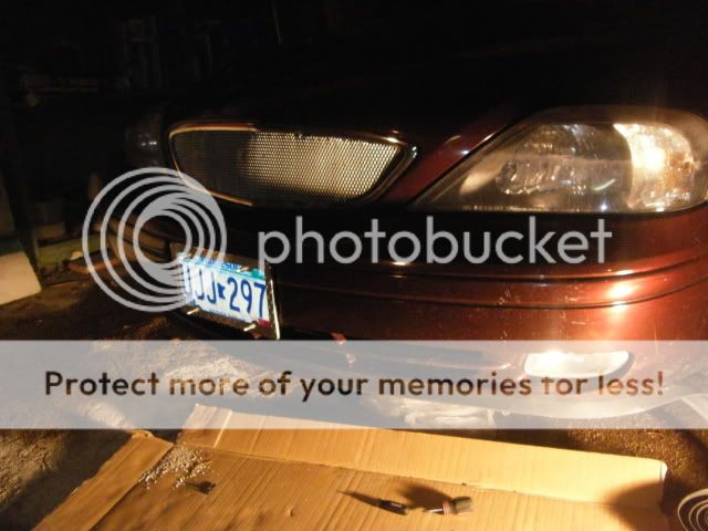

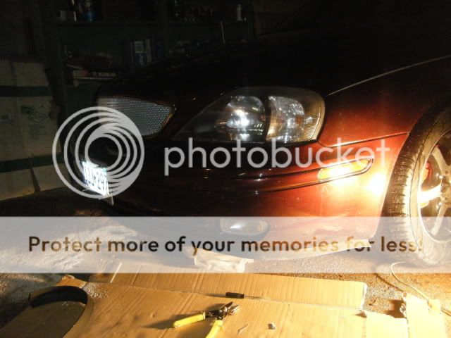

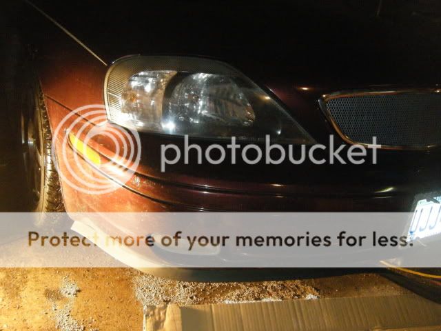

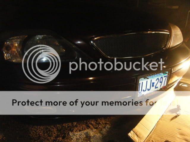

well i finaly got around to doing the garage door seal lip on my sable it was dark out so i dont know for sure yet if i am going to be totaly happy with it anyway i got to be up at 6 so here are the pics i will add more info tomorrow

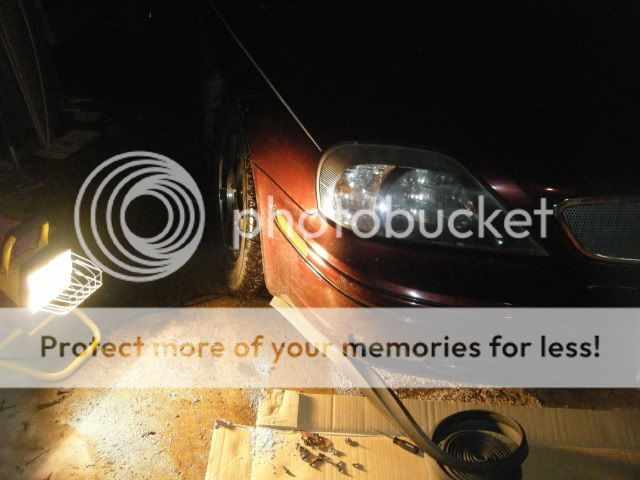

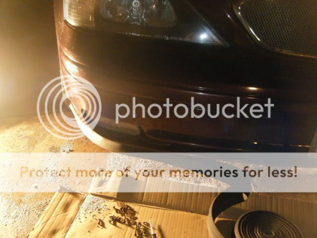

alright just got back from school. i cant remember where i saw this at but it is definatly a cheaper alternative to the mach chin spoiler. it is just a garage door seal it is made of a rubber foam and is very tough it is designed to withstand the elements and should not easily tear or rot. it can be had for about 12 bucks for a big roll i still have a bunch left from doing the sable so i may do something on the contour with the rest. i still had a bunch of screws from my old gen 1 when i stripped it down so i used those and it was too late to go buy washers so i used pennies and just drilled holes through them they were the perfect size (they are also cheaper than buying washers lol). just start on one end and go around the bumper making sure you have the screws close enough together so that the strip does not sag significantly. a tip for you guys is that i used a straight pick with a sharp tip to start my holes it made it much easier. now mine you can tell exactly where the screws are because it sags a tiney bit in between but i think if i get out the staple gun for in between the screws it will look alot better i will let you guys know how that goes when i get around to it lol. i will get pics up in a little bit i am going to go take some now but i am not promising a clean car lol
edit: i forgot to mention that the gen 4 sable (and maybe taurus) have a body line on the bottom of the bumper that is perfect to use as a guidline
ok here they are!

Looks cool. Can you take some close ups of the actual material you used and how it's attached (placement, not the screws)
Discussion Starter #14
well i took a couple pics not exactly sure what you meant on the second part but here they are i hope they help!
Yep, those pictures were exactly what I was looking for :D
I was just trying to get a better idea of what the door seal thing looked like and how it was attached. I knew what they were, but I've never seen one other than in magazines.
