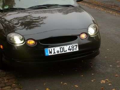

Just got done doing my projector lamp install on my 99 SHO and am happy to report that it is the best purchase I have ever made. I bought a complete kit with the harness, ballast projectors and shrouds and the end result is....well I can finally see to drive at night and really enjoy it. Pics are up on the gallery page under 99 SHO in Germany. Have thought about even starting to sell as a kit for Gen 3 owners as nobody else seems to make them for us.

Looks great!!! Projectors always make a car look aggressive and sexier.
A+!

Thanks for all the comments. Looks like I may be going into Bussiness if this keeps up.....Is there a demand for these??? Tell me if you think so. Somebody has to do it....might as well be me.

Actually mine are the D2S, not the H1's ....basicly the same thing ....and yes make sure and get the complete kit. If you don't you will have headaches. The Morimoto Ballast and the harness are a must to go along with the projectors. Angel eyes are up to you, but they do look good. What year are you planning to retrofit????

Winter project???? trust me ....it won't take you that long to do them.....I did mine in a matter of hours .....the whole 9 yards. It is well worth the investment if you plan on keeping and enjoying your Taurus
