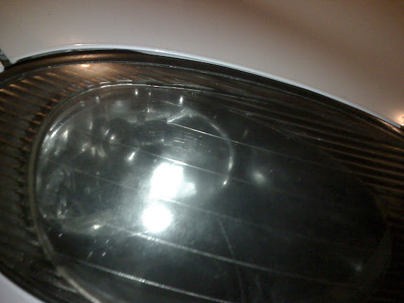

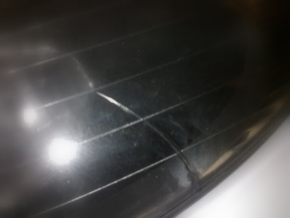

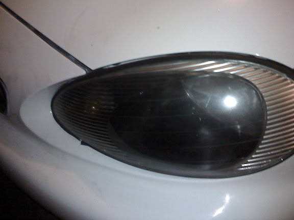

I did mine black, and it looks bad-ass! The only thing i did wrong was crack my passengers side lens... :(
Will post pics after I get off my lazy ass to do it. hahaha :banana:
EDIT: Pics as promised:
Drivers side
Passengers side (cracked)
Close-up of crack
