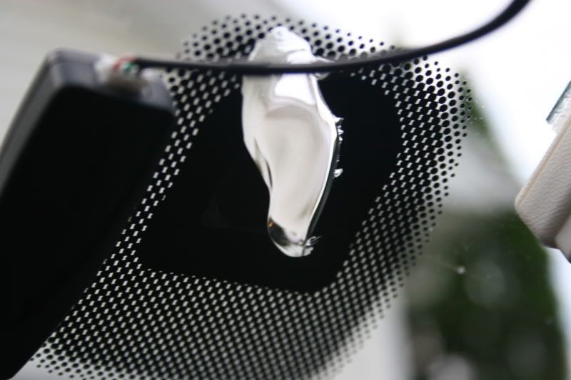

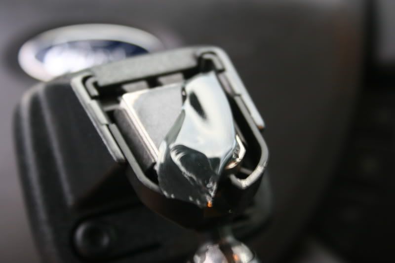

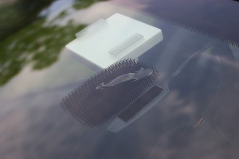

So, my autodimming mirror with compass came today in the mail. Perfect weather to be outside, so I decided to install it. I have an auto dim already, but with the 04-07 the message center you can only have temperature OR compass, so with this I figured I can have both. It came out of a 02 Sable. Perfect. I get the other mirror all ready, and unplug mine from the harness. I go to take the mirror off. No big deal right? you just slide it up right? Well it was being a stubborn sob. I put a little upward force, and it came loose! Then i heard a weird sound, and open my eyes. OH COOL.
So now I need to get a new windshield. Has anyone seen this happen before? I've seen glass crack, but never peel or "chip" like this from the inside...

Yup, looks like a new windshield. For future reference, the mirror doesn't just slide up, you have to insert a small screwdriver in that slot in the top and pry the windshield away from the base. It's held on by a spring clip.

Oh, and I didnt mean pry the windshield from the base, I meant mirror from the base.

that sucks. at least for now it doesn't look like it went completely through. Depending on your insurance you might be able to get it replaced for free. I know geico does it.
WOW. I have a huge crack going through my windshield right where the mirror is attached and I've pulled it off several time and nothing's ever happened.

Mike, thats happened to me before. Just get some of that compound they sell at autozone for mounting the mirror to the windsheild, fill in the glass and everything then coat the mirror, push and hold for 2 min and u should be good.

We did that on my moms cutlass supreme, except a week later on some really rough roads, the windshield cracked from the middle down to the missing chunk.
