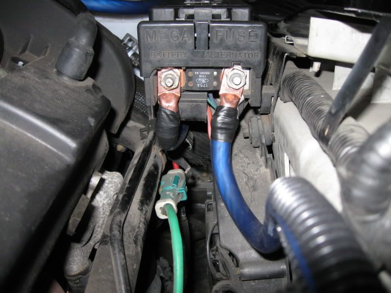

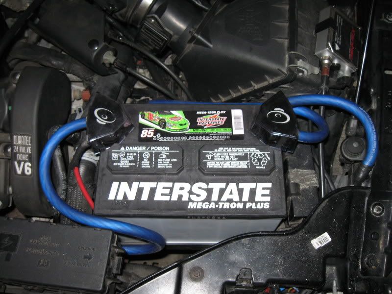

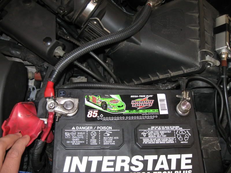

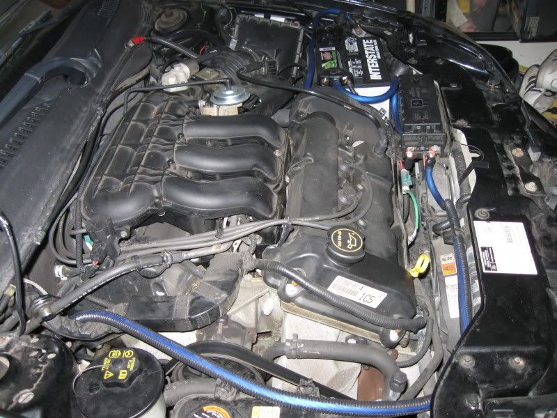

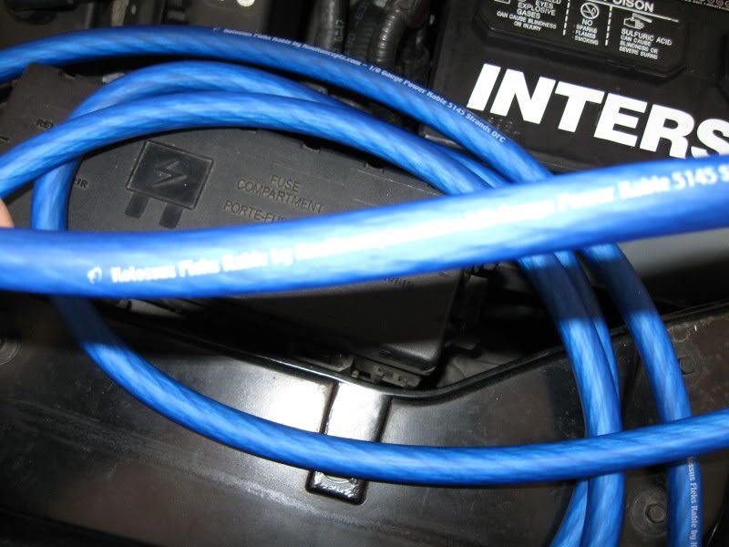

I used 1/0 gauge knukoncept kollosus flek cable.I also used knukoncept battery terminals. Here are some pics I took not the greatest but you get the idea.
kollosus Flek Kable 1/0
Here is the old
Here is the new wiring and terminal
battery/alternator terminals
Full view

1,159 Posts
pretty much what the big 3 upgrade means improving the current capacity of your 3 cables. You have your alternator positive to battery positive, then you have battery negative to chassis, and engine ground to chassis. It lowers the resistance, smaller voltage drops, also give you more stable voltage and better current flow.
