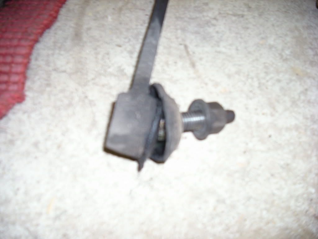

Just returned from cleaning the subframe, dropping the tranny and pulling the clutch & pressure plate.
I'll need both sides... here's another:
And now another question... how do I loosen the flywheel bolts? The whole flywheel spins when attempting and my impact gun won't budge them.
Thanks for helping me get it back together and on the road!

That's what I did.... very little room to squeeze in a socket & then C clamped in a ratchet - worked like a charm - thanks.
My Y pipe is on the way... thanks SHOSource! Great communication on the order and fast shipping. The gasket & seal along with the shifter bushings came in yesterday.
The wife laughed when she saw my new SHO mechanics t-shirt this morning :lol2: Very true in my case!
I'll wait a bit before ordering the end links in case I need some other stuff.
