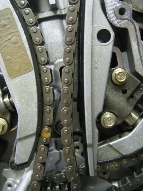

I have a 2001 3L I'm building for my contour SVT. All the timing marks are correct but at one point during the rotation there is a lot of slack on one side of the chain. This occurs on right and left bank. I think it's because there is more tension on the cam opening valves than the one with no tension not opening valves. Plus the hydraulic tensionsioners have no oil in them. I think I'm good but want some reasurance.

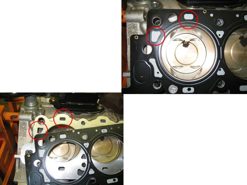

Also there are no holes in the locations below. Fel-Pro #9540PT and #9541PT. I think it has to due with the way thay cast it. Anyone now for sure?
the person you are going to want to talk to is Spriget either here or on taurusowners.com i am pretty sure he has just about the most experience pulling these things apart.
