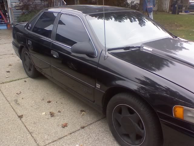

Pics!
Like i said, its lowered, but not by that much, mabye an inch at most. But after the springs break in a little bit its gonna look sick B)
Oh, did I mention I need to get both quarter panels replaced along with the floor boards?
yeah, thats going to get done in a week or two, going around and getting quotes. i want to get it now before it gets any worse.
