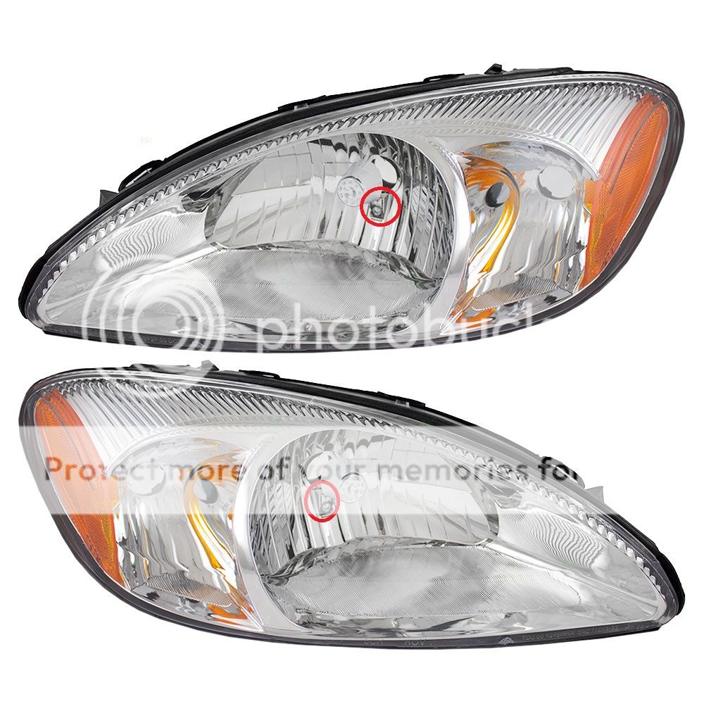

next i let them cool for about 10min then took the rear housing to the garage and marked where the stock light was shining just for reference so i could get the projectors around the same spot. after i done that i took the end glare caps off the reflector housings then dremeled off a piece of plastic that the end glare cap screws into(circled in red in one of the pics).

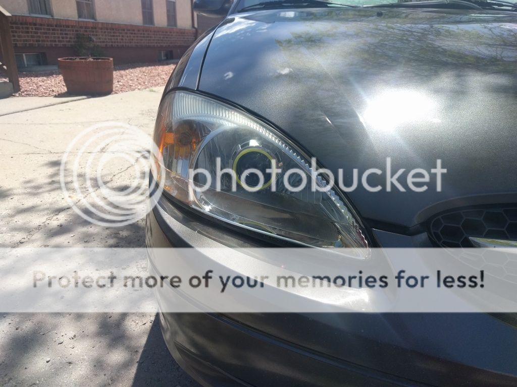

heres my before pic(only got 1):

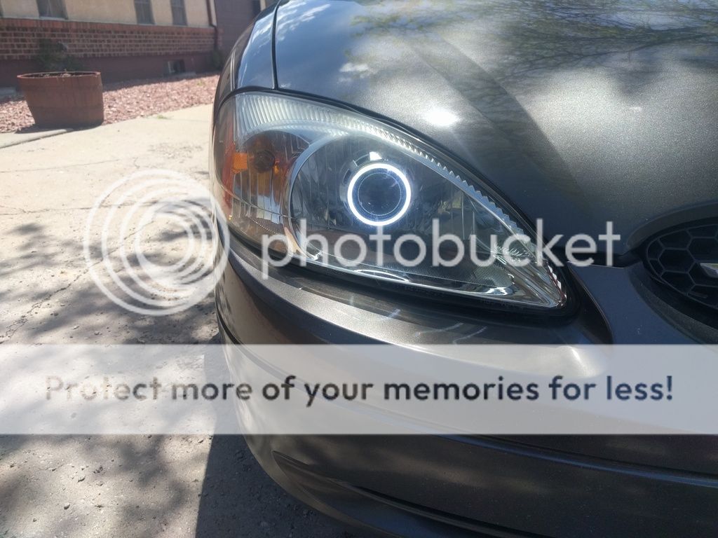

heres after(again ill update this tomorrow night with a better pic with car and camera in same position as the before pic:

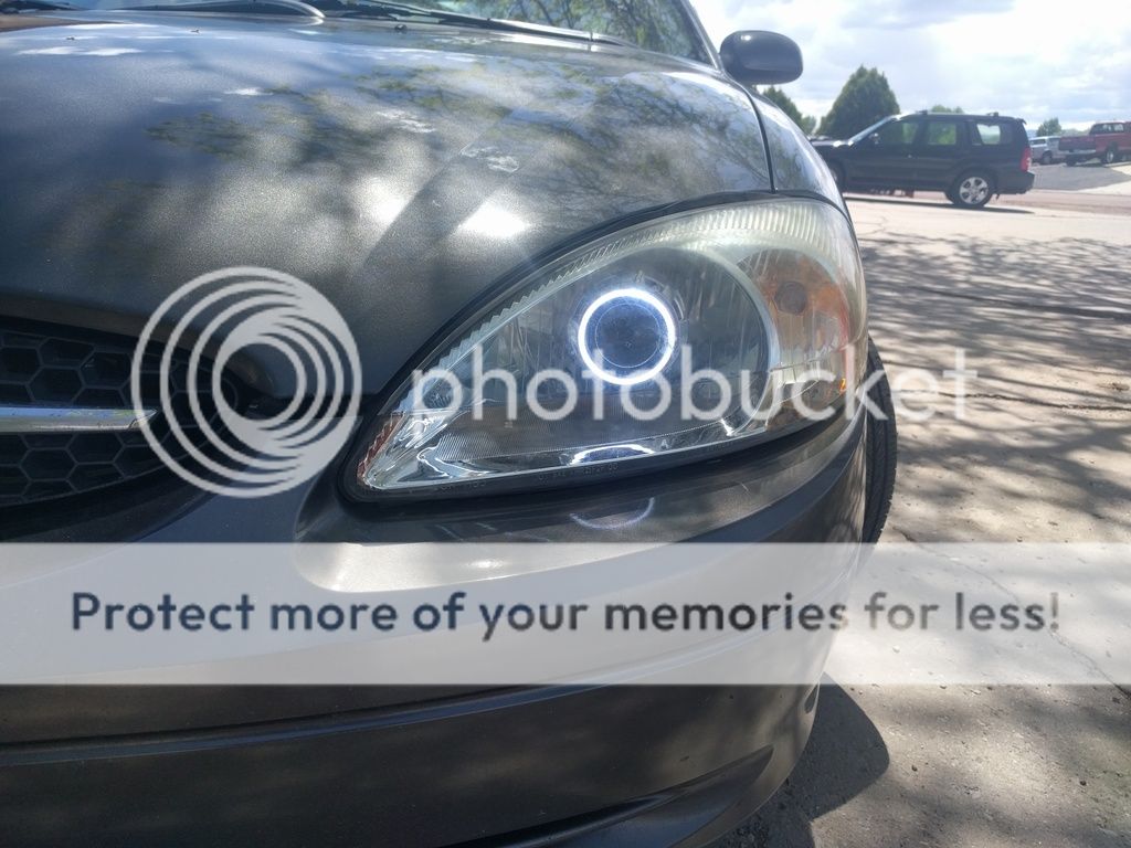

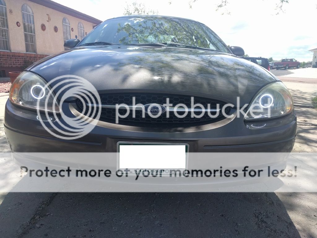

heres the finished product in light:
heres a pic of the housing with the piece circled that i had to dremel off.
im satisfied with the install, but if i was to change anything it would be the halo's i would of liked to of got a set of halos that was not yellow when powered off, but alas its not a big enough deal to me to tear it apart and change them out.

Nice work! Looks like they're aimed pretty darn good to me.
thanks, its actually not all that hard to do either. but about the aiming the height is about perfect but the left and right(horizontal) i feel is slightly crosseyed so i am going to brainstorm a little to figure out what i can do to remedy it, if i cant do anything then o well its not bad enough to sweat over.
