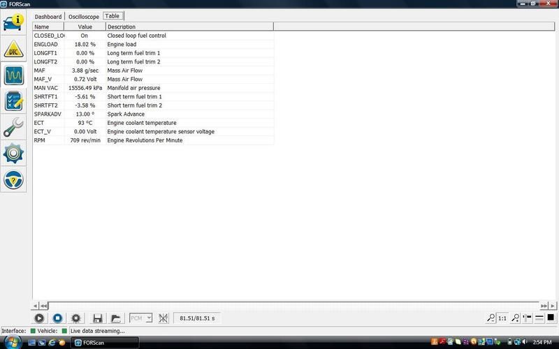

12. The check engine light isn't on, but I think it is burned out. I hooked up my laptop with Forscan (another great find here on TCCA). I found that the ECT code was set as confirmed fault, but I assume that was from when the ECT was bad when I bought the car. I do not know how many cycles will clear it. There is a possibility that the new ECT is faulty from the store, it runs the fans and I get ECT sensor readings that look believable. Or maybe the wiring from the ECT to the PCM is bad?? I am getting a zero volts reading on ForScan, but a friend told me that since the temp is changing, that maybe that is an option in the software that the PCM doesn't support reading?

I do not know if this will mean anything, but here are two screen caps of ForScan. Of course they are once the car warmed up...[IMG][/IMG]
[IMG][/IMG]
