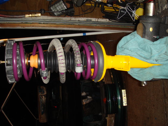

one of the rear struts, not yet painted
close-up of that strut

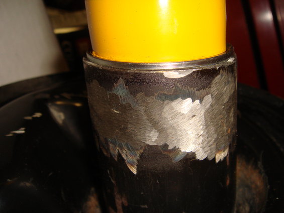

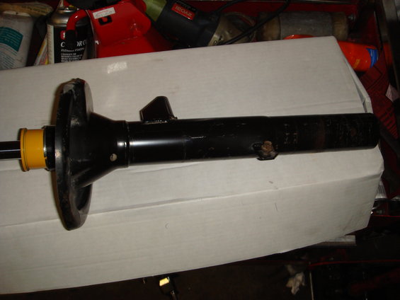

these next two are actually my first of hopefully not TOO many screw-ups. I actually cut the strut tube TOO damn short, so I had to weld it back on, and recut it higher, it turned out quite well.
here is one of the front struts modified and painted

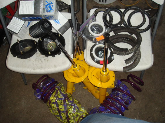

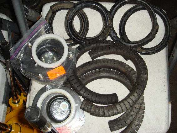

and this is a shot of the OE inserts all cut out, the new KONI inserts mounted, and the spring isolators, etc all in the basket to the left.

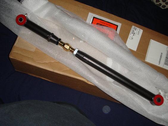

Well, we got our package from BMR, whooo let me tell you, WOW!!!!!
rear adjustable control arms
These things are NIIIIIIICE!!!!!!!!!
