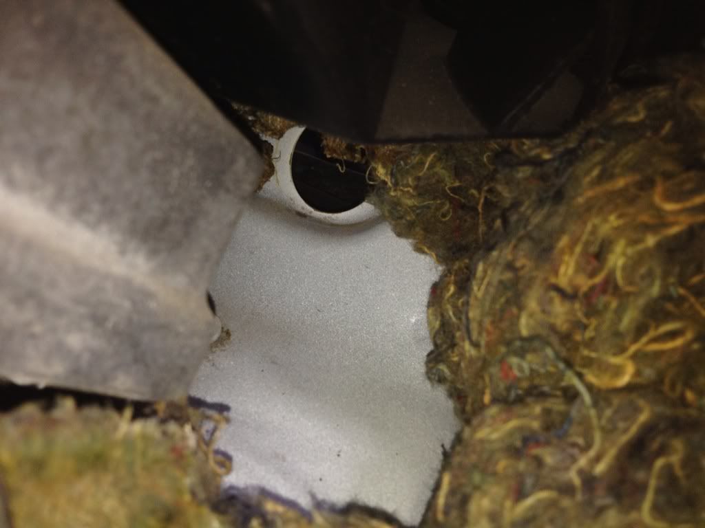

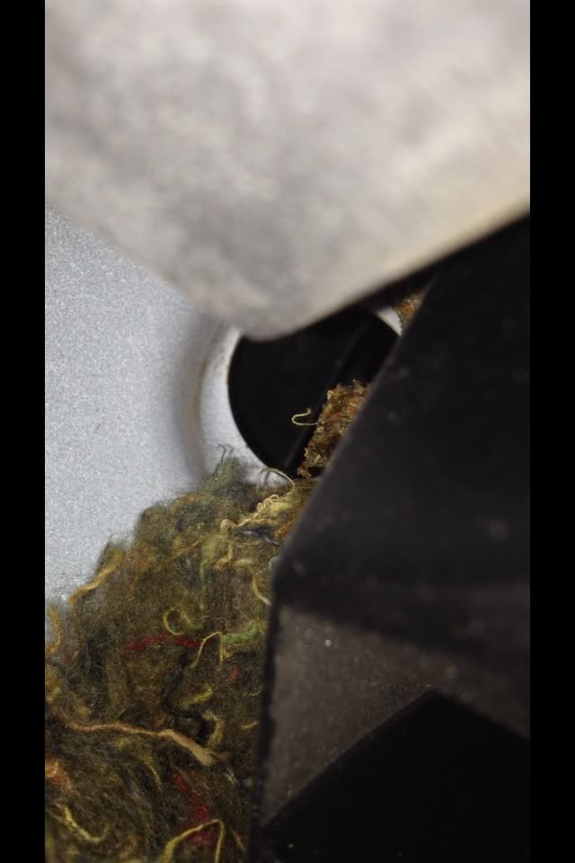

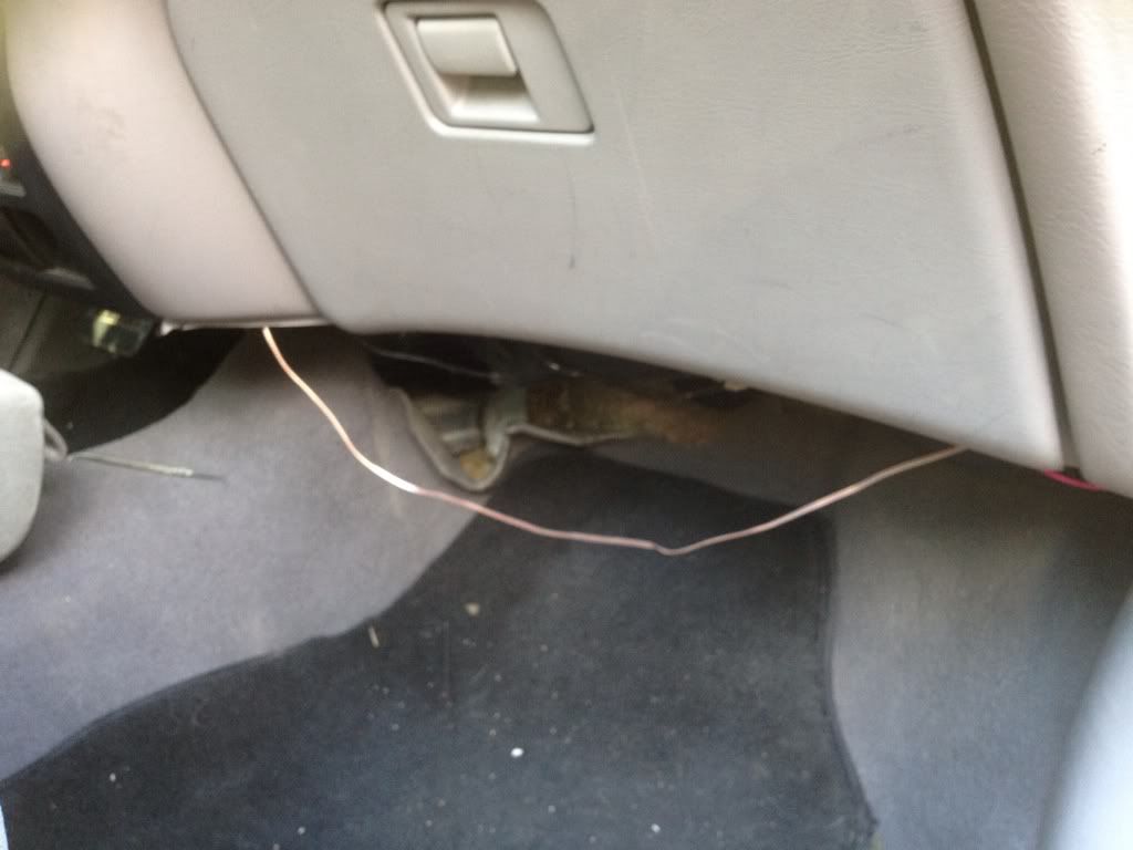

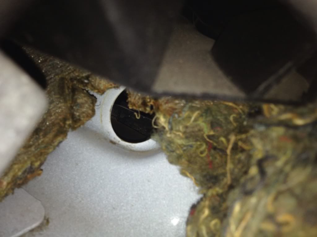

Coming in from the front passenger door, looking at the center of the firewall:
Closer:
and closer:
And CLOSER:
CLOSER:
Closest:

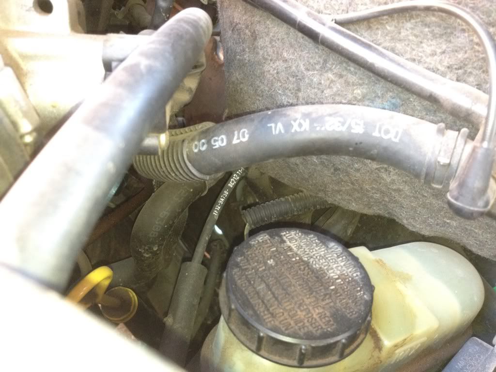

These pics are looking into the engine compartment, behind the engine, from the driver's side (near the air intake).

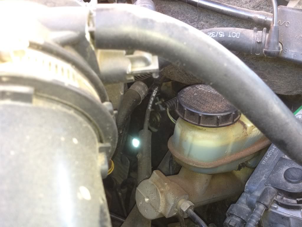

I shone a light through the hole, so you can get an idea of where it comes out behind the engine:

Nice! - Same location as mine (Just on the passenger side)
