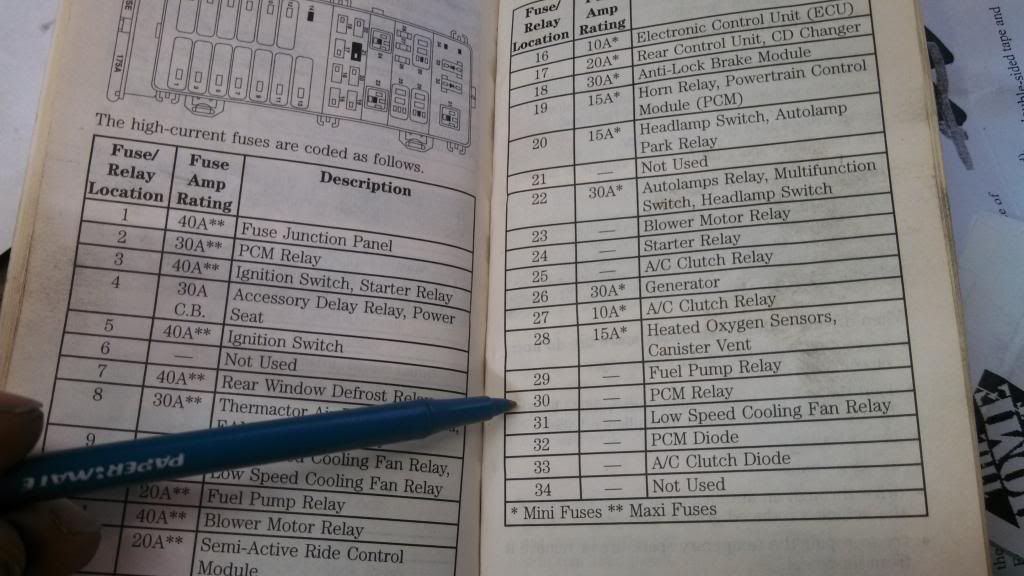

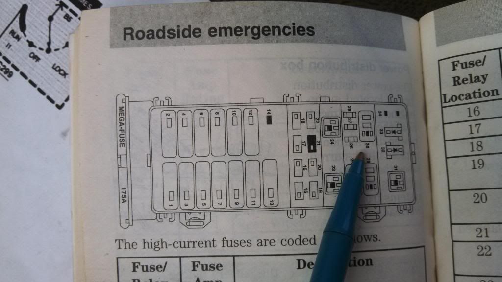

The one i jumped was relay #5 according to my fuse cover, when i look in the owners manual at the layout for the power distribution box its location 30 (PCM relay not the fuse #2)
I've got an ecu side pinout, and just to be correct when looking at the ecu from the front of the car in the engine bay, #1 is in top left and #104 is in bottom right? (like reading a book)
The diagram is very helpful, thanks for your help so far
