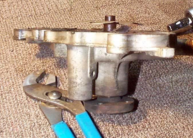

Until you confirm things one way or the other, I'm with Riptides on the coolant pump being eaten away.

H20 pump or core still plugged. You confirmed the blend door actuator is fully operational?

+1 on checking the water pump. Its our bad luck that the cooling system on vulcans in these cars is not maintenance free in the least.

As mentioned, could be this scenario:
