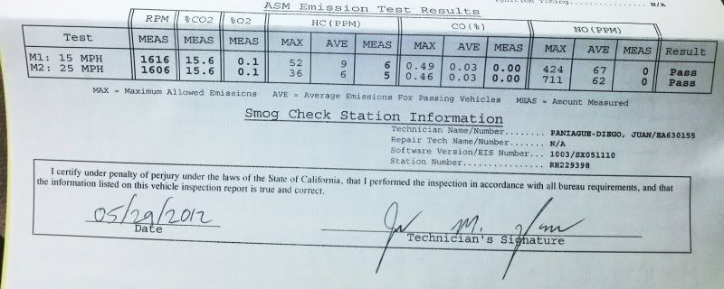

It would be nice to know the other numbers as well (NOX, CO, CO2, and O2 if you have it). Scanning the slip would work too. Example (thanks to Troy):

The rest of the numbers:
%CO2 | %O2 | HC(PPM) | CO(%) | NO(PPM) |
Test | RPM | MEAS| MEAS | MAX GP MEAS | MAX GP MEAS | MAX GP MEAS |
15mph | 2109 | 14.2| 0.5 | 85 271 206 | 0.50 2.00 0.31 | 695 1918 439 |
25mph | 1532 | 14.1| 0.6 | 50 221 238 | 0.47 1.97 0.28 | 717 1718 561 |
dfordg is offline   Reply With Quote

The other numbers are fairly high as well, so your catalytic convertors are probably not working very well. But HC are still really high so you have some sort of combustion problem (running a bit rich).
You mentioned a dirty air filter, so I would replace that and clean the MAF. You might also think about changing the oxygen sensors?
