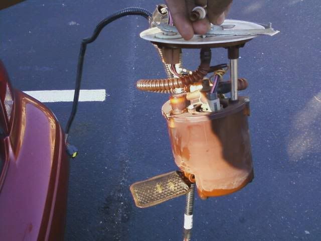

Posts: 8
Here is the pump assembly after i removed it

I saw the arrow and I tried prying it up a little with a screw driver but it seemed like it was going to break the plastic. Mine has two tabs that stick out on top that seem they are there for twisting it but it won't move. I appreciate your help!
