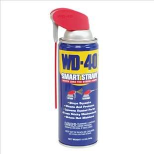

I would take it a step further and do this...
First give each door latch mechanism a good soaking of this...
Then follow it with this...
I've been doing this for years, it just becomes part of the regular maintenance!

eh with the whole doing it for years thing, i mean on my sho, i tried wd40 and i tried kroil, but to be honest, if you just use white lithium, you probably wont have to do it again, wd40 is better for getting rid of gunk and buildup, where as the lithium will lube it up real good, make it take alot longer to ware down again. I did it once and its been 8 months, still no problems yet.
