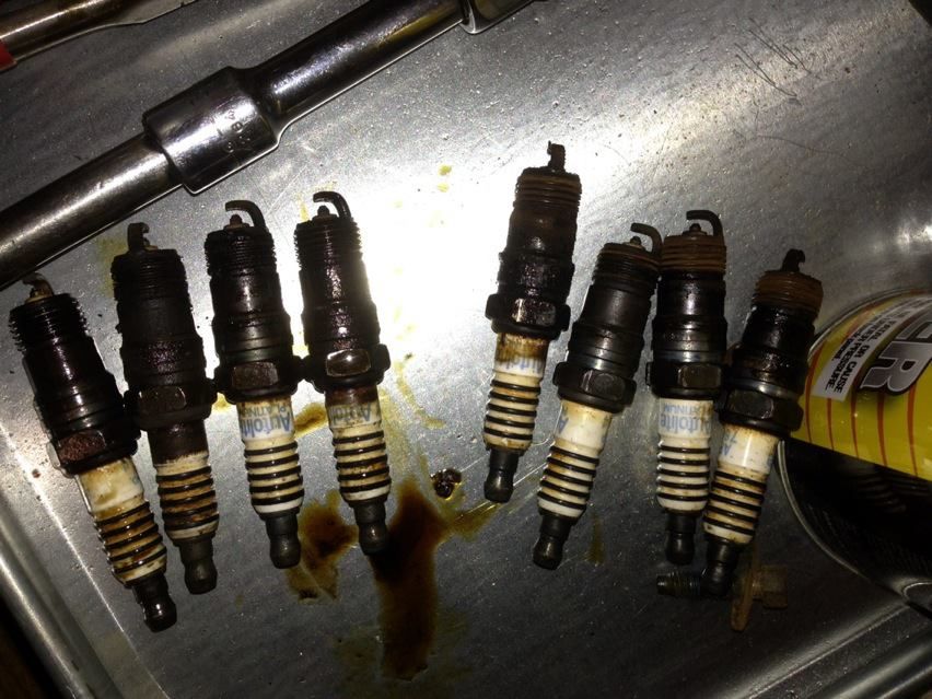

Early December, plans worked out nicely. Mechanic friend diagnosed the car, said heck no, no blown head gasket. If anything, the valve/cam cover and spark plug gaskets need replacement. It smoked like a CHAMP from the oil running down the side of the block onto the exhaust manifold. I rented a tow dolly from UHaul, hitched it up to my friend's 1974 Pontiac Grand Safari. He towed it up the road to a precision welder. He used TIG welding, and welded my camshafts up as documented on V8SHO.com:
Then towed it back home, cleaned everything up best I could, wrapped the harness on the back of the motor in heat tape (good up to 1000F degrees):
Spark plug wells nearest the rad cradle were caked in oil, one was filled up with oil!
Back 4 were rusty.
2 new valve/cam cover gaskets were installed, and 8 new spark plug well gaskets. 8 new Motorcraft plugs. Coils were degreased/oiled, reinstalled. EGR port into Surge tank was deplugged.
