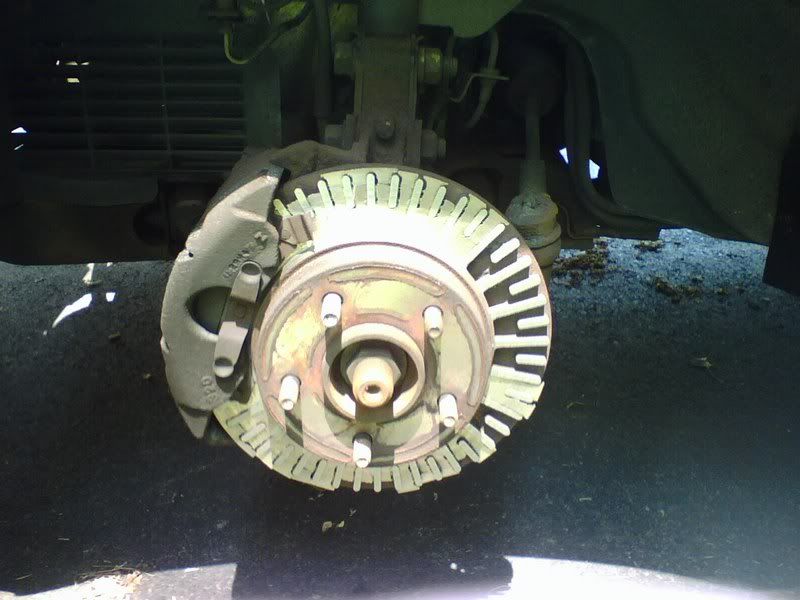

Have you taken a wheel off and looked at the brakes? My bet is you need a full brake job. As said slotted/drilled rotors on a Bull is not necessary unless you are doing AutoX.
Just hope your rotors dont look like this...
My brother told me 2 days earlier that his brakes arent stopping like they did, and he's hearing a grinding noise. Needless to say there was nothing left, because of a bad flex brake hose............ yea he's not smart.

sousa,,,,,,,,,,,,that is one chewed up rotor. Did you get the vehicle like that ? please tell me you check your rotors every now and then.
I'm the one who works on all the cars in my family. I'm also the one that everyone says is ALWAYS working on my cars(which is true). It's not mine cause I'd be embarrased as anything if this was my vehicle.
