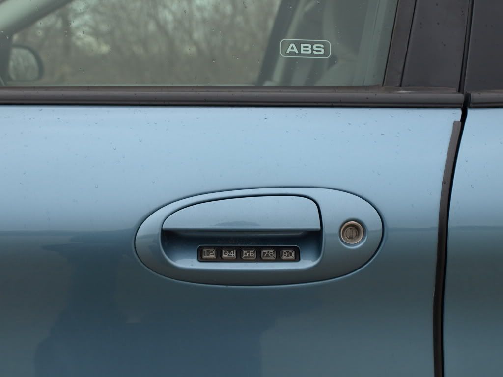

If it's above the door handle, you have an aftermarket one.
This is what it should look like on a Gen4.
